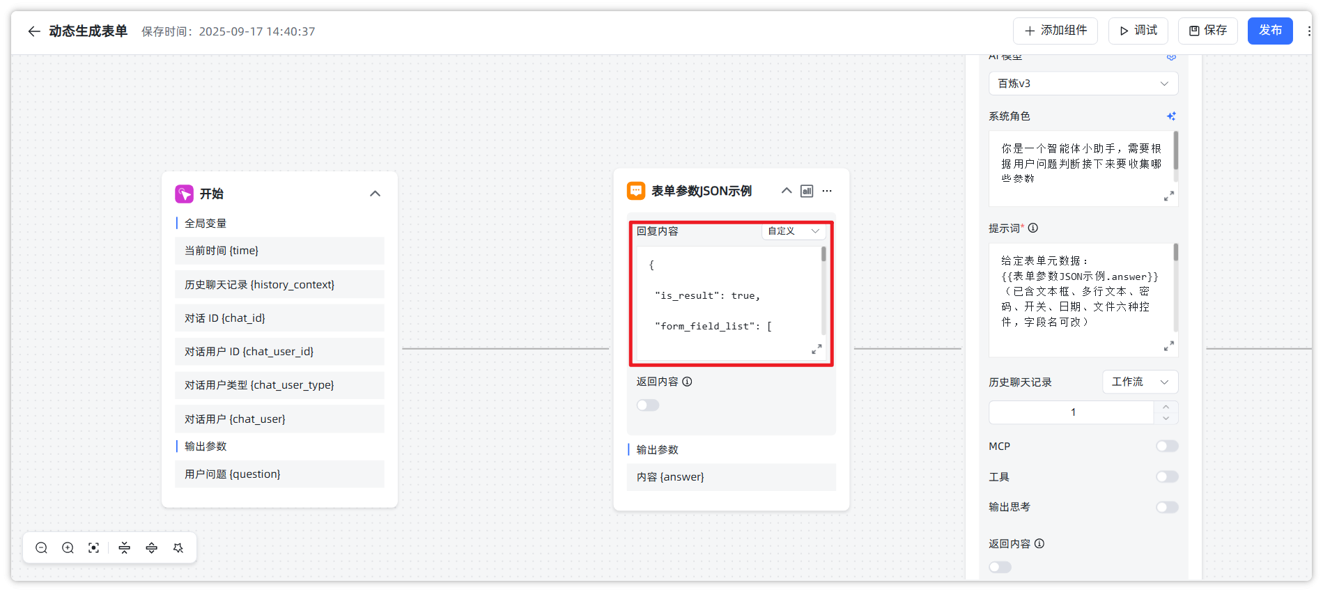

可在编排中添加「指定回复」「AI 对话」「表单收集」等节点,构建动态参数收集与调用链路。工作流参考:
1.指定回复:提供表单参数 JSON 示例
在工作流中添加「指定回复」节点,输入表单收集的 JSON 元数据。例如:
#数据来源于接口抓包:先在表单收集中添加常用的参数类型,然后从应用详情接口中获取 node_data 字段值
                            "is_result": true,
                            "form_field_list": [
                                    "attrs": {
                                        "maxlength": 200,
                                        "minlength": 1,
                                        "show-word-limit": true
                                    "field": "name",
                                    "label": {
                                        "attrs": {
                                            "tooltip": "\u8bf7\u8f93\u5165\u59d3\u540d"
                                        "label": "\u59d3\u540d",
                                        "input_type": "TooltipLabel",
                                        "props_info": {
                                    "required": false,
                                    "input_type": "TextInput",
                                    "props_info": {
                                        "rules": [
                                                "max": 200,
                                                "min": 1,
                                                "message": "\u59d3\u540d\u957f\u5ea6\u5728 1 \u5230 200 \u4e2a\u5b57\u7b26",
                                                "trigger": "blur"
                                    "default_value": "test",
                                    "show_default_value": true
                                    "attrs": {
                                        "type": "password",
                                        "maxlength": 200,
                                        "minlength": 1,
                                        "show-password": true,
                                    "field": "password",
                                    "label": {
                                        "attrs": {
                                            "tooltip": "\u8bf7\u8f93\u5165\u5bc6\u7801"
                                        "label": "\u5bc6\u7801",
                                        "props_info": {
                                    "required": false,
                                    "input_type": "PasswordInput",
                                    "props_info": {
                                        "rules": [
                                                "max": 200,
                                                "min": 1,
                                                "message": "\u5bc6\u7801\u957f\u5ea6\u5728 1 \u5230 200 \u4e2a\u5b57\u7b26",
                                                "trigger": "blur"
                                    "default_value": "password123",
                                    "attrs": {
                                    "field": "switch",
                                    "label": "\u5f00\u5173",
                                    "required": false,
                                    "input_type": "SwitchInput",
                                    "default_value": false,
                                    "attrs": {
                                        "type": "datetime",
                                        "format": "YYYY-MM-DD HH:mm:ss",
                                        "value-format": "YYYY-MM-DD HH:mm:ss"
                                    "field": "date",
                                    "label": {
                                        "attrs": {
                                            "tooltip": "\u8bf7\u9009\u62e9\u65e5\u671f"
                                        "label": "\u65e5\u671f",
                                        "props_info": {
                                    "required": false,
                                    "input_type": "DatePicker",
                                    "default_value": "",
                                    "attrs": {
                                        "limit": 3,
                                        "accept": ".jpg,.docx,.pdf,.md"
                                    "field": "files",
                                    "label": {
                                        "attrs": {
                                            "tooltip": "\u8bf7\u4e0a\u4f20\u6587\u4ef6"
                                        "label": "\u6587\u4ef6",
                                        "props_info": {
                                    "required": false,
                                    "input_type": "UploadInput",
                                    "default_value": [
                                    "max_file_size": 100,
                                    "attrs": {
                                        "autosize": {
                                            "maxRows": 3,
                                            "minRows": 3
                                        "maxlength": 1000,
                                        "minlength": 1,
                                    "field": "multipleText",
                                    "label": "\u591a\u884c\u6587\u672c\u6846",
                                    "required": false,
                                    "input_type": "TextareaInput",
                                    "props_info": {
                                        "rules": [
                                                "max": 1000,
                                                "min": 1,
                                                "message": "\u591a\u884c\u6587\u672c\u6846\u957f\u5ea6\u5728 1 \u5230 1000 \u4e2a\u5b57\u7b26",
                                                "trigger": "blur"
                            "form_content_format": "\u4f60\u597d\uff0c\u8bf7\u5148\u586b\u5199\u4e0b\u9762\u8868\u5355\u5185\u5bb9\uff1a\n{{form}}\n\u586b\u5199\u540e\u8bf7\u70b9\u51fb\u3010\u63d0\u4ea4\u3011\u6309\u94ae\u8fdb\u884c\u63d0\u4ea4\u3002"

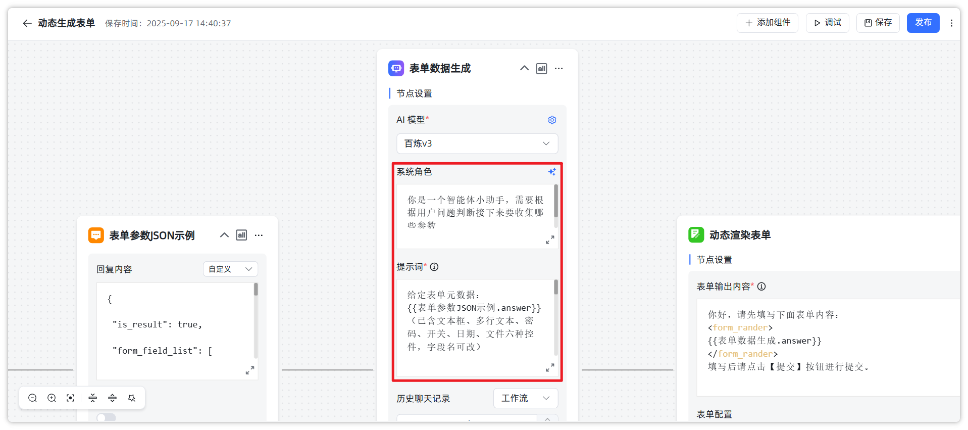

2.AI 对话:表单数据生成
在工作流中添加「AI 对话」节点,配置系统角色和提示词。提示词可以根据实际需要自行调整。
你是一个智能体小助手,需要根据用户问题判断接下来要收集哪些参数
给定表单元数据:
{{表单参数JSON示例.answer}}
(已含文本框、多行文本、密码、开关、日期、文件六种控件,字段名可改)
任务:
仅根据问题「{{开始.question}}」一次性推断出最少且必要的用户输入参数。
用上述控件组合生成一份可直接渲染的表单 JSON,字段命名贴合任务语义。
输出要求:
纯文本,合法 JSON,无 Markdown、无注释、无多余空格。
仅返回该 JSON,任何额外文字(包括“```json”包裹)均不出现。
示例:
- 例如发送邮件需要收集邮件主题、邮件内容、收件人、抄送人(默认不要上传附件)
- 查询路线规划需要收集起点和终点
- 查询天气需要收集城市

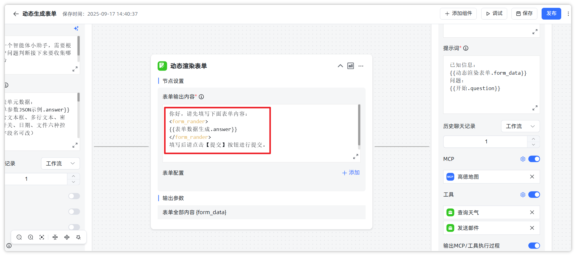

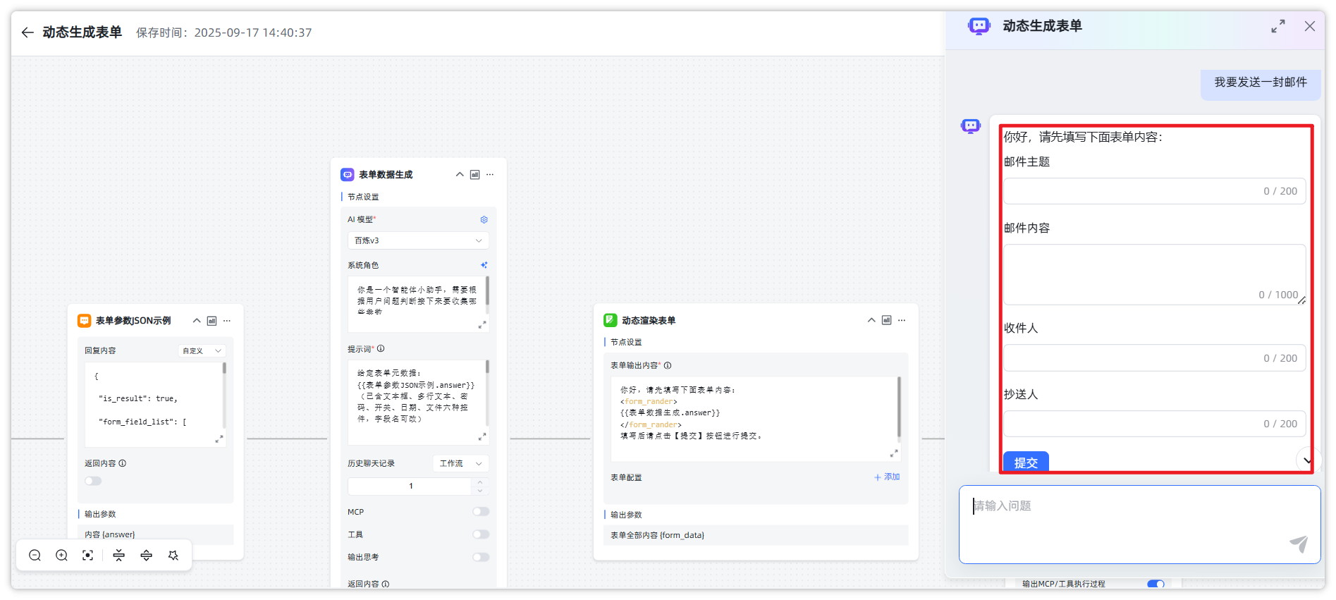

3.表单收集:动态渲染表单
添加「表单收集」节点,使用 <form_rander> 标签动态生成表单收集参数。
你好,请先填写下面表单内容:
<form_rander>
{{表单数据生成.answer}}
</form_rander>
填写后请点击【提交】按钮进行提交。

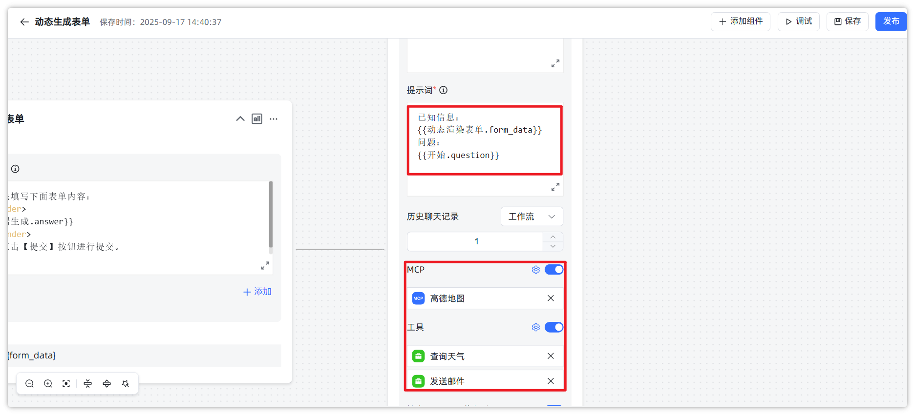

4.AI 对话:根据参数调用 MCP
添加「AI 对话」节点,在 节点中配置提示词、MCP 及相关工具,传入已收集的参数。
已知信息:
{{动态渲染表单.form_data}}
问题:
{{开始.question}}

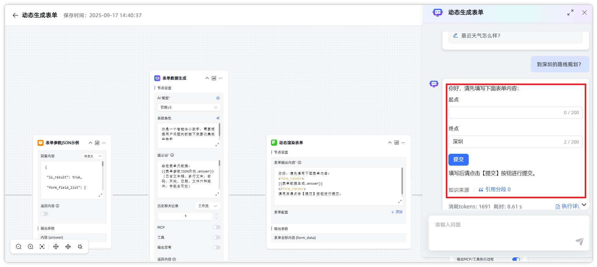

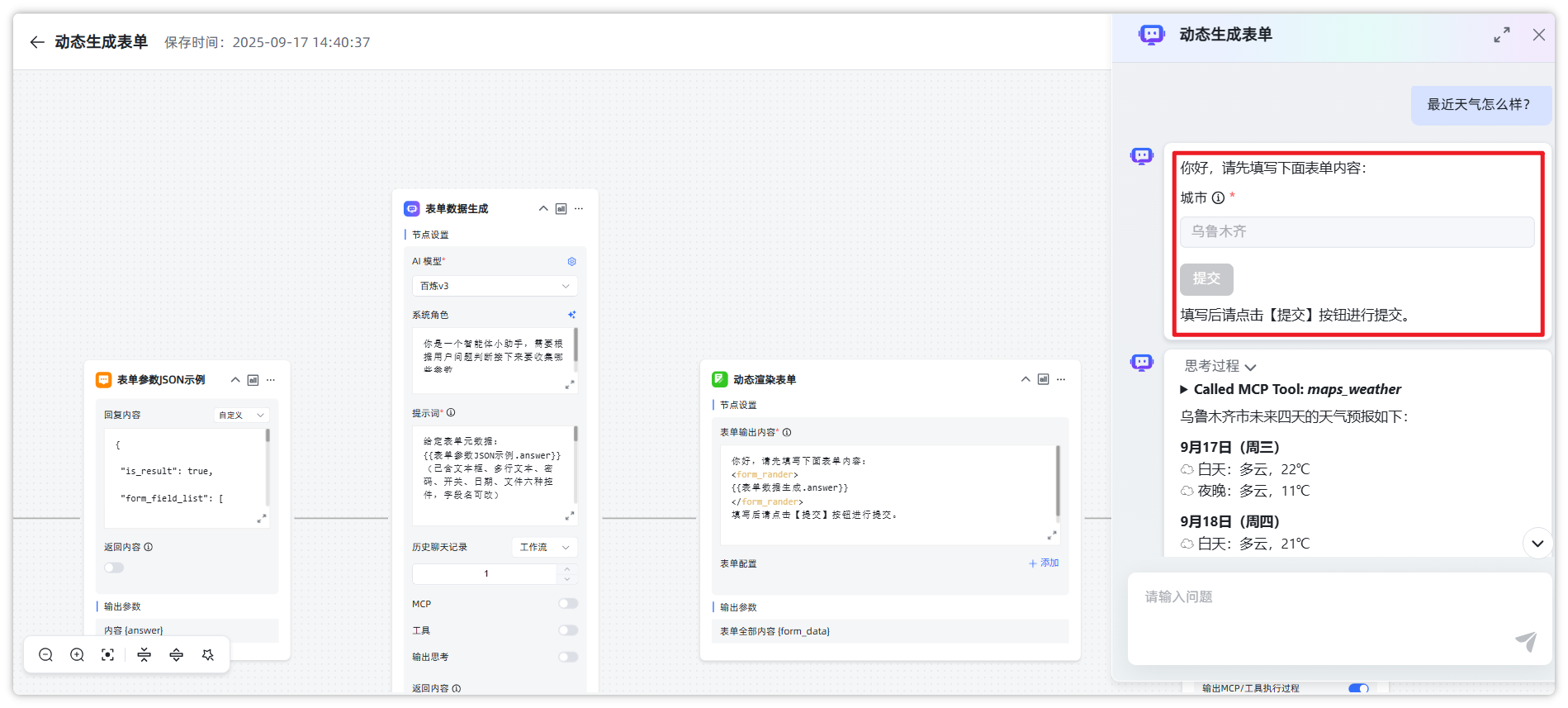

5.测试效果
完成上述配置后,输入相关问题即可动态生成与问题关联的表单收集参数并传递给后续节点。
