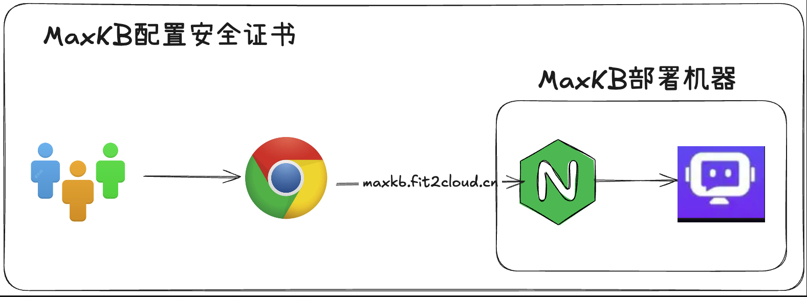

2.Nginx 部署测试

  • 准备启动文件
cat > /fit2cloud/scripts/nginx/docker-compose.yml <<'EOF'
services:
  web:
    image: nginx:1.27.5
    container_name: nginx
    hostname: nginx
    ulimits:
      core: 0
    restart: always
    ports:
      - 80:80
      - 443:443
    volumes:
      - ./logs:/var/log/nginx
      - ./cert:/etc/nginx/cert
      - ./conf:/etc/nginx/conf.d
EOF
  • 启动 Nginx 容器
docker-compose -f /fit2cloud/scripts/nginx/docker-compose.yml up -d
[+] Running 2/2
 ✔ Network nginx_default  Created                                                                                     0.1s
 ✔ Container nginx        Started

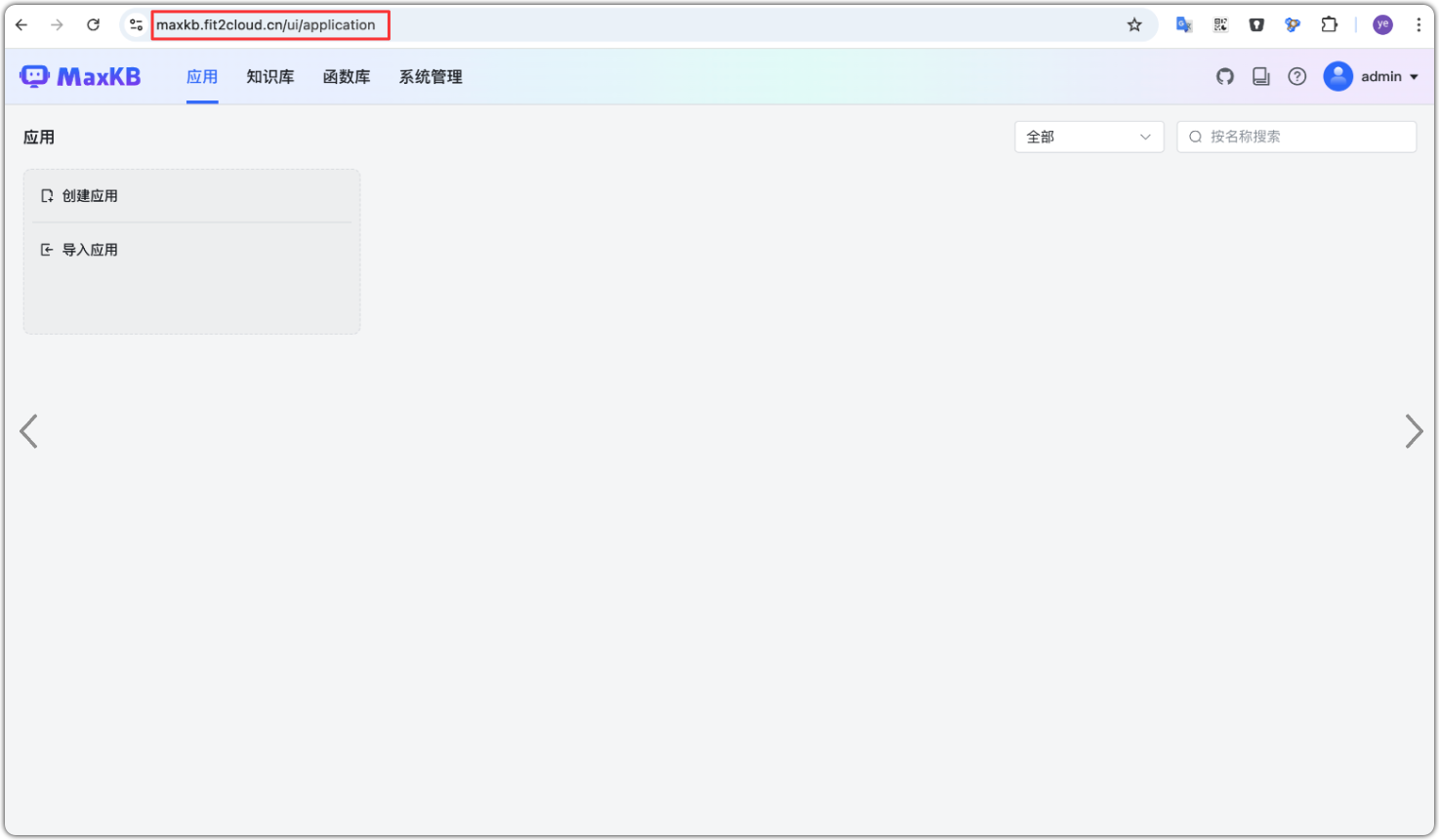

3. 测试访问
配置完成后,通过浏览器访问 ,如果页面正常显示且地址栏显示安全锁标志,说明域名证书配置成功。
